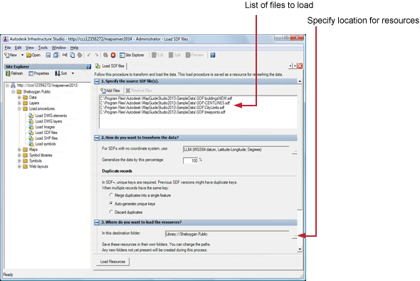

This procedure assumes that you have one or more SDF 2 or SDF 3 files that you want to load. To load an SDF file, you drag one or more source files to the Site Explorer. Autodesk Infrastructure Studio converts SDF 2 files to SDF 3 format and automatically creates a new layer for each file as well as a new feature source.
To load an SDF file
A new load procedure is displayed to the right of the Site Explorer. It contains a list of the files to load. You can drag other files into this load procedure.
The coordinate system you select here will be used only if there is no coordinate system already defined for the source file or files.
Autodesk Infrastructure Studio creates a new feature source and a new layer for each SDF file.
The Layer Editor is displayed to the right of the Site Explorer. (For more information about the Layer Editor, see Working with Feature Source Layers).
You can rename the new feature sources and the layers in the Site Explorer.
