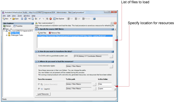

This procedure assumes that you have one or more DWF files that you want to load. To load a DWF file, you drag the source file to the Site Explorer. Autodesk Infrastructure Studio automatically creates a new layer as well as a new feature source.
To load a DWF file
A new load procedure is displayed to the right of the Site Explorer. It contains a list of the files to load. You can drag other files into this load procedure.
DWF files do not have a coordinate system assigned to them, so you always need to specify it.

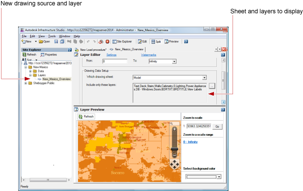

Autodesk Infrastructure Studio creates a new drawing source and a new layer for each DWF file.
The Layer Editor is displayed to the right of the Site Explorer.
(For more information about the Layer Editor, see Working with Feature Source Layers
You can rename the new drawing sources and the layers in the Site Explorer.
