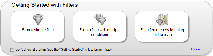

If the expression startup page is turned on, buttons representing different expression types are displayed. You can click one of these buttons to insert an expression template.
Click one of these buttons to start with a sample expression.
To prevent these startup buttons from displaying each time you create an expression, select the Don’t Show At Startup check box. You can redisplay them later by clicking Getting Started.
To close the startup page, click Close.
