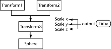

This illustration combines a DAG hierarchy with a dependency graph. Transform1, Transform2, Transform3, and Sphere are all DAG nodes (and also dependency graph nodes) while Time is just a dependency graph node.
The x, y, and z scale parameters of Transform3 are driven by time. Alternatively, you can think of the output of Time being plugged into the x, y, and z scale connections of Transform3. When the animation is played back, the two instances of the sphere increase in size.

For example, consider the sphere in the above figure. If no DG node is connected to Transform3 to affect the sphere’s scale, any values set through the UI or API will be the new scale. However, if as in the figure Time affects the scale of the sphere, the effect would be different when Transform3’s scale is additionally modified through the UI or API. If you set the scale it would override the scale being set by Time only until the next re-evaluation of the dependency graph, when the scale of the sphere would again be set by Time and the value you set through the UI or API would be lost.
