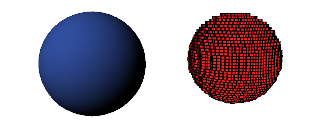

Rendered Output: The following rendered image was obtained by voxelizing the mesh of a sphere. We applied a blue lambertian material to the original sphere, and a red surface shader to the voxelized mesh. The voxelized mesh was also assigned a Toon outline with a line width value of 0.223.
            Program Summary: The plug-in code below creates a new MPxNode which accepts a mesh as input, as well as user-defined attributes to determine the voxel width and inter-voxel distance. This voxelizer node transforms the input mesh into a new mesh consisting of cubes, which fill the volume occupied by the original mesh. The voxelization process makes use of MFnMesh.allIntersections() to cast rays from inside the bounding box of the original mesh towards the camera. Assuming that the mesh is closed, if the ray intersects with an odd number points along the mesh's surface, then the origin of the ray is contained within the mesh.
