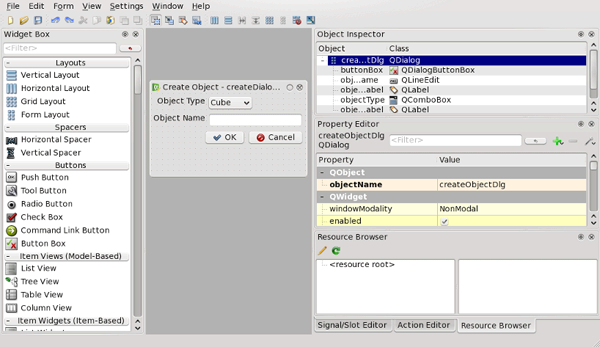

Qt's Designer tool can be used to interactively create graphical interfaces and save them out in a portable XML format. Maya provides the loadUI command which can be used by MEL and Python scripts to load these files into Maya and translate them, where possible, into standard Maya controls.
The following image demonstrates Qt Designer being used to create a simple dialog consisting of a combo-box, a text field, their associated labels, and a button box below with two buttons.

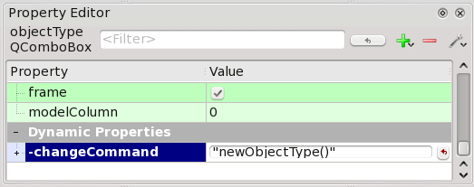

Flags can be passed to the command used to create a control by adding dynamic properties to the widget within Qt Designer. The name of the property should match that of the flag, including the leading hyphen, for example -width. If you want the control to be created using Python rather than MEL, then replace the leading hyphen with a + instead, for example, +width. If you specify both MEL and Python flag properties for the same widget, the behavior is undefined and therefore may result in errors. If the flag takes one or more arguments, specify them as the property value.
The image below shows the -changeCommand property being added to the comboBox in Qt Designer.
When the corresponding optionMenu control is created, its -changeCommand flag will be set to execute the command string "newObjectType()".
