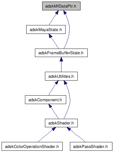

Include dependency graph for adskMIDataPtr.h:
This graph shows which files directly or indirectly include this file:
