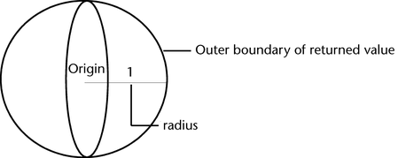

sphrand(1)
Returns a vector whose randomly selected coordinates reside within an imaginary sphere centered at the origin and with a radius of 1. An example returned vector is <<0.444, -0.427, 0.764>>.

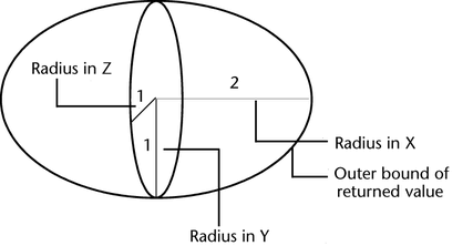

sphrand(<<2,1,1>>)
Returns a vector whose coordinates reside within an ellipsoid centered at the origin and with a radius of 2 along the X-axis, 1 along the Y-axis, and 1 along the Z-axis.
You can use the sphrand function, for example, to create a cluster of 500 particles randomly positioned within an ellipsoid having a radius of 2 in the X-axis, 1 in the Y-axis, and 1 in the Z-axis.
