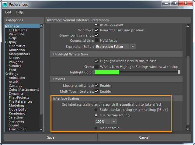

You can adjust the resolution (scale) of the Maya LT interface to take advantage of running on high resolution displays, like Ultra HD or 4K monitors, or Retina displays and tablets. The interface can scale to provide better readability of icons and text.
To change interface resolution
