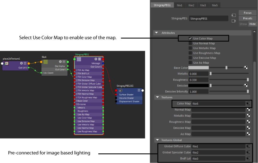

In addition, three files are pre-connected for image-based lighting, and their connected file nodes are shared amongst all Stingray PBS nodes in the scene. You can find these connections in the Textures Global section of the Attribute Editor.

Connect these maps in one of two ways:
Using the Attribute Editor
Select the Stingray PBS node.
icon where you want to connect a map (for example,
Color Map).
This creates a file node, and displays its attributes in the Attribute Editor.
Using the Hypershade
In the Hypershade work area, create a File node, and navigate to your texture map. See Create and connect nodes in the Hypershade.
Connect the OutColor output of the File node to the map input attribute of the Stingray PBS node; for example, TEX Color Map.
Enable the corresponding Use * Map attribute (for example, Use Color Map) in the Attribute Editor.
