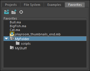

The Favorites tab in the Content Browser displays files you tag as favorites. This Favorites information is stored in the favs.json file in your Maya LT installation \prefs folder.
To add a favorite file, do either of the following:
icon.
To remove a file from the Favorites tab, do either of the following:
icon.
On the Favorites tab, you can create custom folders, as well as shortcuts to favorite folders on local or network directories. This folder information is stored in the userLibs.json file in your Maya LT installation \prefs folder.
To create your own library folder
icon on the Favorites tab.
To add path shortcuts to user library folders
icon on the Favorites tab, or right-click the folder you want and choose
Add Library Path.
To remove a library folder or path shortcut you created
icon at the top of the Favorites tab.
