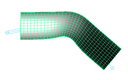

Smooth skinning provides smooth, articulated deformation effects by enabling several joints to influence the same deformable object points. The smoothing effects around joints are automatically set up when you bind skin.

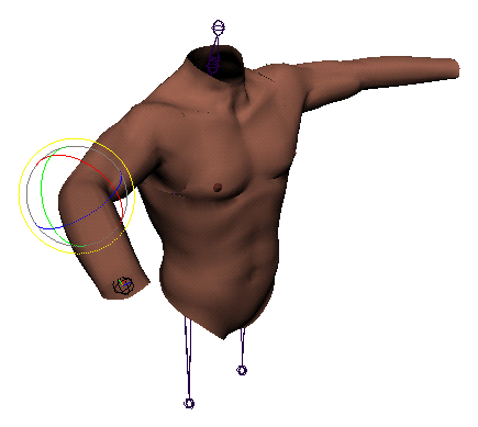

Maya provides smooth deformation effects by allowing several nearby joints to have varying influences on the same skin points (NURBS CVs, polygonal vertices, or lattice points). With default smooth skinning, the amount of influence varies with distance, but you can also define influences using other binding methods. Once you have basic skin point weighting set up, you can refine and edit by painting weights on a joint-by-joint basis.
To explore some examples now, see Example workflows for smooth skinning.
The smoothing effects around joints are automatically set up when you bind. By default, the effect of each joint on a smooth skin point depends on the joint’s proximity to the point.
