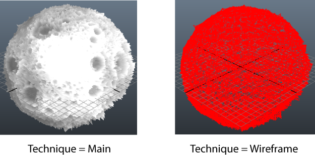

To write a custom GLSL shader, save it as a .ogsfx file. See the TessellationExample.ogsfx file in the ..\presets\GLSL\examples folder of the Maya installation for an example of how to write a GLSL shader that supports tessellation. The example demonstrates how to write the tessellation control shader, tessellation evaluation shader and geometry shader in the graphics pipeline.
In this shader, two techniques are defined: the main technique, which displays a shaded view, and the wireframe technique, which displays a wireframe that illustrates tessellation. To set the inner levels and outer levels of the tessellation, you can adjust the Inner levels/100*100 pix (the number of inner levels in a 100 x 100 pixels area) and the Outer levels/30 pix (the number of levels for every 30 pixels segment) settings and see the effect in Viewport 2.0.
The Wireframe technique definition includes five stages of the graphics pipeline, and in the following order:
