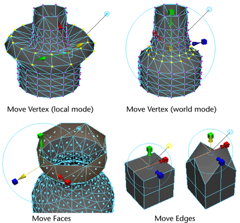

You can use move, rotate, or scale polygon components in the following ways:
Transform Component also has additional constraints that Maya’s generic transformation tools do not have, such as moving perpendicular along normals.

To create a history node to transform components
Maya creates a transformation node (polyMoveComponentType) and automatically switches to the Show Manipulator tool, allowing you to edit the node.
The manipulator is a standard move/rotate/scale combined manipulator, with an extra handle to switch between Local axes and World axes. Moving components along their local Y can be very useful to move components “inward” or “outward”.
