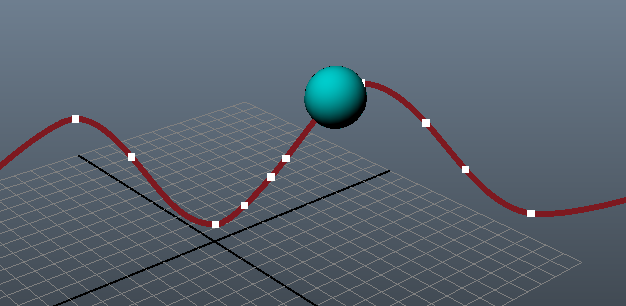

Motion trails
With motion trails, you can display and edit the trajectory of an object. With motion trails, you can display and edit the trajectory of an object. Motion trails work with objects that are animated by keyframe animation, deformers, or motion capture. You can create the motion trail before you animate an object or after. See Motion trails and Create an editable motion trail.
Note: Motion trails are only editable for objects with keyframe animation.
