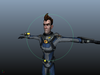

To get a good view of the area illuminated by a spot light
This represents the view from the spot light, with the green circle representing the light cone boundary. Objects outside the circle are not lit by this spot light.
Camera tracking, tumbling, or dollying work well in this view to help shine the spot light exactly on the desired area.
