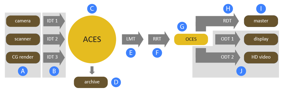

The ACES workflow uses standardized input and output transforms for each device.
| A | Inputs from different sources may use different color spaces and encodings. |
| B | Input Device Transforms (IDTs) convert images to ACES. IDTs may be supplied by device vendors, software vendors such as Autodesk, other third parties, and AMPAS itself. In addition, you can author your own. The ADX to ACES transform is known as the "universal unbuild". Its inverse is the "universal build". |
| C | The Academy Color Encoding Specification (ACES) is a scene-linear encoding and can be used as both a connection space and working space. The reference viewing environment is outdoor daylight with a white point of D60. |
| D | ACES images can be saved for exchange or archiving in a constrained, or limited, version of the OpenEXR file format with extra metadata. The only allowable channel layouts are stereo and non-stereo RGB and RGBA. This is a SMPTE standard. |
| E | The Look Modification Transform (LMT) is optional. It may be inserted before the RRT to provide an aesthetic effect, such as a shot-specific color grade that needs to be shared throughout a workflow. It is typically established by the cinematographer on set. It can be baked in to the final output, or simply used for dailies and as a reference for the final color grade. |
| F | The reference rendering transform (RRT) applies a transformation as a first step in preparing the images for viewing. Among other things, the RRT:
There is only one RRT allowed in the ACES 1.0 standard. However, the Autodesk Color Management transform collection also includes beta versions of the RRT to support older projects that may be using them. |
| G | The Output Color Encoding Specification (OCES) represents the desired output colors if there were no dynamic range limitations. These values are the colors you would project in a cinema viewing environment if you had an idealized wide-gamut, high-dynamic range display device. |
| H | The reference device transform (RDT) converts images from OCES so that they are viewable on a SMPTE reference projector. The RDT is used as a reference for developing ODTs for other devices. |
| I | The output of the RDT forms the digital cinema distribution master (DCDM). |
| J | Different output device transforms (ODTs) are applied to prepare the images for display on other devices. As with IDTs, the ODTs may be supplied by device vendors, software vendors such as Autodesk, other third parties, and AMPAS itself. |

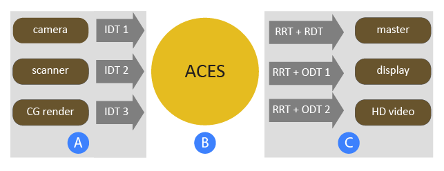

The output transforms supplied with Autodesk Color Management combine the RRT and ODT, as well as the optional LMT, to convert directly to a format suitable for specific devices.
| A | Autodesk Color Management ships with a variety of IDTs. These transforms can be found in the camera and film categories. In addition, you can use IDTs from other sources. |
| B | ACES can be used as a working space, or as a connection space for your chosen working space. |
| C | There is a variety of combinations of RRT and ODT available in the RRT+ODT/ directory. The combination of RRT and RDT to render the DCDM is the ACES_to_DCI-D60 transform. |
