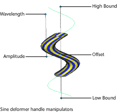

To edit sine deformers by using the handle manipulators
  1. Select the sine deformer node (default name: sinen).
  2. Select the Show Manipulator Tool (default shortcut: t key).
  3. The manipulators on the sine deformer handle let you edit attributes interactively.
  4. In the scene, select one of the manipulators on the sine deformer handle. Middle-drag the mouse to edit.
    The Channel Box updates the values you are changing.
