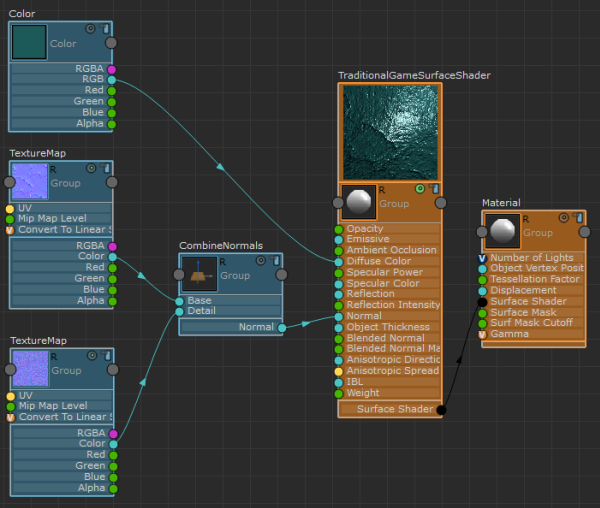

Create this node by selecting: Hw Shader Nodes > Textures > Combine Normal Maps in the ShaderFX editor.
You can provide two normal maps for your shader graph: the base normal map with a lower resolution, and an additional, more detailed, higher resolution one to provide finer bump details for the model.
Connect your base normal map as a Texture Map to the Base attribute of Combine Normal Maps, and the detailed normal map as a Texture Map to the Detail attribute, then connect the Normal attribute of Combine Normal Maps to the Normal attribute of your TraditionalGameSurfaceShader.
