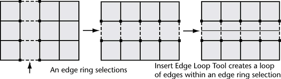

The Insert Edge Loop Tool lets you select and then split the polygon faces across either a full or partial edge ring on a polygonal mesh.
The Insert Edge Loop Tool is useful when you want to add detail across a large area of a polygon mesh or when you want to insert edges along a user-defined path.
For a description of an edge ring, see Select an edge ring.
For quick ways to insert simple edge loops, see Insert an edge loop with Quad Draw and Insert an edge loop with the Multi-Cut Tool.
When you insert an edge loop, you are splitting the polygon faces associated with the selected edge ring. The Insert Edge Loop Tool lets you insert one or more edge loops across a full, partial, or multidirectional edge ring.
