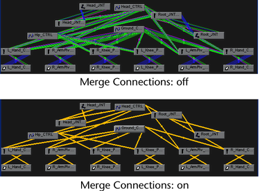

You can condense multiple connections from one node to another using Options > Merge Connections. This displays all parallel connections as a single bold connection. If you mouse over a bold connection line, the Hypergraph displays the names of all connections that line represents.

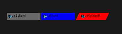

You can visually review the performance impact of various nodes in your scene using the Heat Map Display option in the Hypergraph.
When Heat Map Display is on, Maya colors the nodes in the Hypergraph according to the node’s timed performance. You can monitor many different metrics using Heat Map Display, including the number of callbacks, computational calculations, dirty updates or draw times. Nodes that take longer to perform in the specified metric are colored from blue to red as they pass various thresholds. This allows you to quickly identify expensive or inexpensive nodes.
By default, the color scheme of the Heat Map Display is as follows:
Colors are measured by percentage. By default, the node with the highest timing value in the network is red while the node with the lowest non-zero timing value in the network is blue. Values between the low and high timing value appear in a spectrum from blue to red. You can customize the upper or lower threshold or remove nodes above or below a certain performance threshold in the Heat Map Display options.
