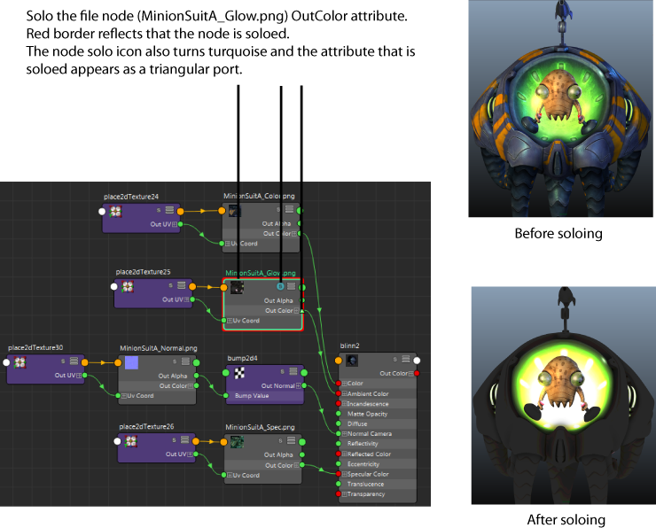

You can recognize a soloed node by its red border, by the soloing icon on the node which changes to turquoise, as well as by the soloed output port which becomes triangular.
When the node is soloed, its soloing icon turns turquoise
, and the border of the node turns red.

A soloed attribute appears as a triangular port
