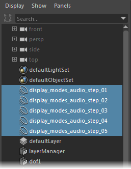

If you import a sound file into your scene, and decide later that you no longer need that soundtrack, you can delete the audio node from the
Outliner (choose
), or use commands in the
Edit menu on the main menu bar.
Note: To see audio nodes in the
Outliner, make sure to turn off the
filter.
To delete audio from the scene, do any of the following:
- Select the audio node in the Outliner, then press the Delete key or choose
from the main menu bar.
- Choose
to delete all audio files in the scene.
- Select and delete specific audio files from the
menu.
