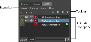

The Animation Layer Editor lets you manipulate animation layers and change the way they blend together to create your result animation.
Note: Maya LT supports a maximum of two animation layers on top of the BaseAnimation. If you open or import a Maya file that contains more than two animation layers, or if importing more animation layers into your scene exceeds the maximum, Maya LT merges the animation and removes the layers.
The Animation Layer Editor contains the menu bar, toolbar, and animation layer pane.
