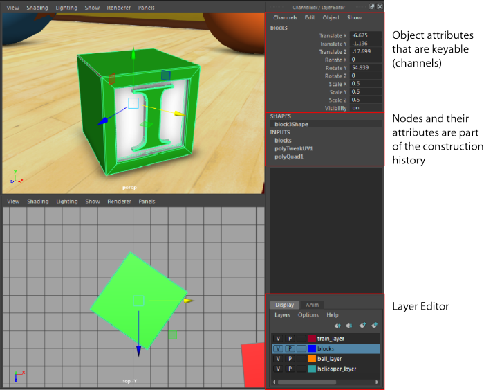

When you select a geometric object, the Channel Box displays these sections:
| Section | Usage |
| objectName | Lists the keyable transform attributes that translate, scale, and rotate the object’s absolute position in the world space. Also shows the object’s visibility attribute. |
| SHAPES | Lists the names of nodes that define the geometry of the object. Other nodes, such as related particle emitters may be found here. |
| INPUTS | Lists the names of other nodes that affect this one. Typically, these comprise the construction history of the node. |
| OUTPUTS | Lists the names of the output nodes (nodes that receive data) for this node. |
