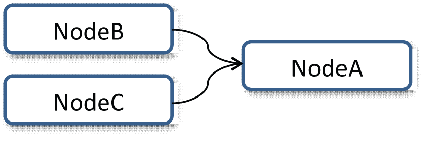

The following is an example report that shows missing dependencies between two nodes:
Detected missing dependencies on frame 56
NodeA.output <-x- NodeB
NodeA.output <-x- NodeC [cluster]
Detected missing dependencies on frame 57
The "<-x-" symbol indicates the direction of the dependency. The "[cluster]" term indicates that the node is inside of a cycle cluster, which means that any of nodes from the cycles could be responsible for attribute access outside of evaluation order
In the above example, NodeB accesses the "output" attribute of NodeA, which is incorrect. These types of dependency do not appear in the Evaluation graph and could cause a crash when running an evaluation in Parallel mode.
