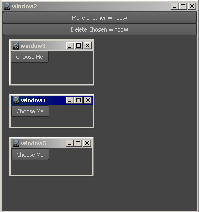

In this example, MEL makes a window that can be used to create more child windows. The $chosenOne global variable tracks which child window the user has selected. Within each newly created child window, there is a chooseMe button that the you can click to set that specific window as the $chosenOne. When you click Delete Chosen Window in the main, parent window, the $chosenOne gets deleted.
In the image below, window4 is the $chosenOne, and will be deleted when Delete Chosen Window is clicked.
The code is as follows:
