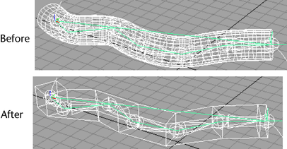

In the following figure, an object’s smoothness is changed from a default medium level of quality to a custom hull quality level.

To display all geometry, select Full. To display hulls only, select Hull.
Together, these settings subdivide the NURBS patches for display purposes to give it the appearance of a finer mesh. The range is from 0 to 32.

If you have the Geometry set to Hull, you can use these settings to control the number of hull divisions displayed.
