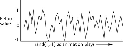

If you were to execute rand(-1,1) repeatedly as an animation plays, its return values might occur as in this figure:
