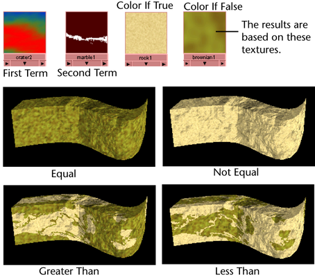

The following shows some examples of the Condition utility in use:
To map the Condition utility to four textures
This texture represents the Second Term’s texture coverage.
This texture represents the pattern of the coverage.
This texture represents the surface color.
This texture represents the color of the overlying texture.
