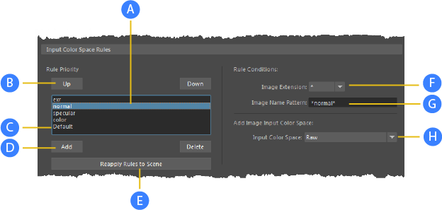

When you add an image input such as a
File texture or image plane to a scene, the
Input Color Space Rules in the
Color Management preferences determine the color space that is assigned initially. You can still change the color space manually in each node's attributes (see
Specify the color space for textures and other image inputs).
A rule lets you automatically assign an input color space based on the file extension, the file naming conventions that you use for different types of images, or both. For example, if all your diffuse color textures include "color" in their file names then you can create a rule that matches *color* and any extension to
sRGB (or whatever color space the files actually use), and if all your normal maps include "normal" in their names then you can create a second rule that matches *normal* and any extension to
Raw. For another example, if all your OpenEXR files are scene-linear with the sRGB primaries, you can create a rule that matches any file name (*) and the extension EXR to
scene-linear Rec 709/sRGB.
- A. Rules list
- Select a rule. You can edit the selected rule using the options on the right.
- B.
Up,
Down
- Rules are applied in order from top to bottom. The input space specified by the first rule that matches is initially set as an image's
Color Space attribute. Use the
Up and
Down buttons to move the selected rule.
- C.
Default rule
- The input space specified by the
Default rule is used when no other rule matches. You can only specify the input color space — you cannot specify a condition to match. The
Default rule is always the last in the list and cannot be moved. If you choose not to define additional rules, you can set this to the color space used by most of your image files.
- D.
Add,
Delete
- Add a new rule to the top of the list, or delete the selected rule.
- E.
Reapply Rules to Scene
- Reapplies the rules to change the
Color Space attributes of existing image nodes in the scene. Image nodes with
Ignore Color Space Input Rules checked on are not affected.
- F.
Image Extension
- Specify the file extension to match in the selected rule, or use * for any extension.
- G.
File Name Pattern
- Specify the pattern to match in a file name for the selected rule. Strings are case-sensitive, and use the so-called "glob" syntax for pattern matching.

- H.
Input Color Space
- Select the color space to assign to files that match the selected rule.
