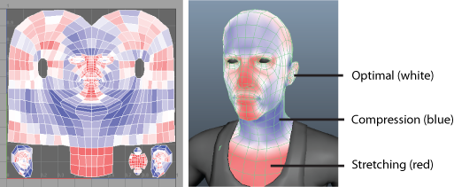

The distortion shader lets you easily pinpoint UVs that are stretched or compressed. Color feedback lets you visualize distortion errors: red faces indicate stretching, blue faces indicate compression, and white faces indicate optimal UVs.

Areas of distortion are shaded relative to the texture area in UV space.
