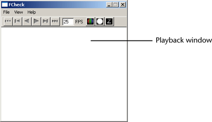

FCheck displays two windows. The FCheck Playback window appears on all platforms and displays images or sequences you open. Depending on the platform, the menu items in the Playback window are different.
FCheck remembers the previous settings when it opens. For example if you view an animation sequence at 60 FPS, the next time you use FCheck the FPS will be set to 60.

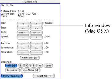

The FCheck Info window is unique to Mac OS X. Use it to control and modify the image or animation.
