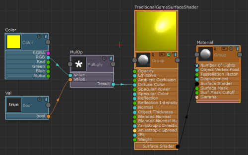

In this example, the Color value is multiplied by 1 or 0, depending on Bool. When Bool is set to true, Color is multiplied by 1 and Diffuse Color is yellow. When Bool is set to false, Color is multiplied by 0 and Diffuse Color is black. Therefore, Bool directly supplies a value to the shader.
