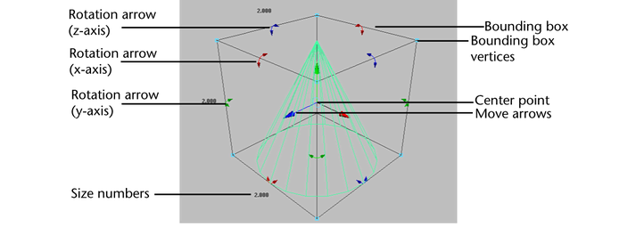

The Universal Manipulator combines the functions of the Move Tool, Rotate Tool, and Scale Tool. You can also use it to enter precise values to scale and rotate your object directly in the scene view.
To show the Universal Manipulator, do one of the following before or after selecting an object:
The Universal Manipulator interface appears around the object.
The rotation arrows are color-coded based on what axis they are rotating around (red for the x-axis, green for the y-axis, and blue for the z-axis). A selected arrow is yellow.
The Universal Manipulator does not work on components such as vertices, faces, and so on. To manipulate components, use the Move, Rotate, and Scale Tools.
