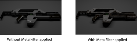

Several filter substances are available, including: Windscreen_Glass_01, Water_Drips, Make_It_Tile, MetalFilter, StoneFilter, and MakeItFurry. A filter lets you plug an input image (file node) in to the substance node; for example the Make_It_Tile substance lets users create a seamless tiling material from a simple image or photograph.
