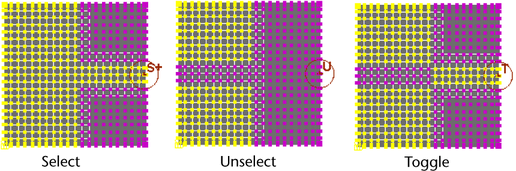

Paint Operations
Select one of the following paint operations.
Select
Selects painted components.
Unselect
Unselects selected painted components.
Toggle
Unselects selected components and selects unselected components.
Tip:
  • To unselect selected components while Select is chosen, press Control and paint over them. Similarly, when Unselect is chosen, press Control and paint to select unselected components.
  • U + click and select the paint operation from the marking menu that appears instead of the from the Tool Settings editor.

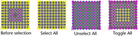

Select All
Selects all components on the selected surface(s).
Unselect All
Unselects all selected components on the selected surface(s).
Toggle All
Selects all unselected components and unselects all selected components on the selected surface(s).
