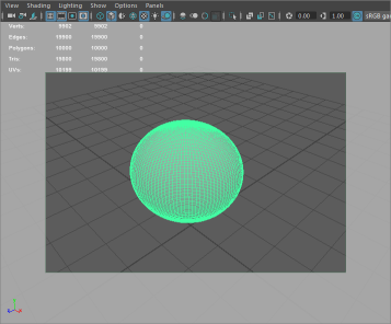

This creates the LOD group in your scene, and hides all but one level in the group, depending on your camera view.
Expand each LOD_n sub-group to see the associated mesh (or meshes).
