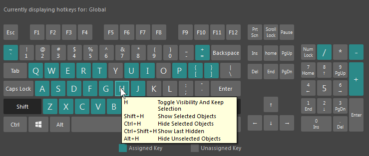

Check for assigned hotkeys
The hotkey editor has an onscreen keyboard graphic that gives you a few ways to verify if your chosen hotkey combination is already used elsewhere in Maya.
- Press a modifier key (such as Shift or Alt,) to display assigned and unassigned keys that use that modifier key(s) on the onscreen keyboard graphic.
- Hover over a key on the onscreen keyboard graphic for a moment to display a tooltip box that lists the assigned keys for that particular key.
- Set the filter setting to Hotkey in the Search By menu and enters a hotkey combination in the Search field to see if that combination is already in use by the search results returned by the Hotkey Lister.
