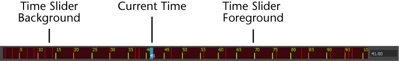

You can change the color and size of various elements of the Time Slider to suit your own working style. The settings are in the Windows > Settings/Preferences > Preferences.
Key Ticks are red (by default) marks in the Time Slider that represent the keys you set for the selected object. Breakdowns are a special type of key displayed as green marks in the Time Slider. See Breakdowns.

You can customize the color settings for the Time Slider to increase visibility, especially for larger timelines.
To open the color settings for the Time Slider
To change the color of the Current Time Indicator
To change the color of the Time Slider foreground or background
Change the Time Slider Foreground and Time Slider Background settings.
