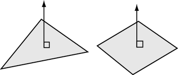

A normal is a theoretical line, perpendicular to the surface of a polygon. In Maya, normals are used to determine the orientation of a polygon face (face normals), or how the edges of faces will visually appear in relation to each other when shaded (vertex normals).
The front of a polygon’s face is graphically represented using a vector called the polygon’s normal.
The order of vertices around the face determine the direction of the face (whether a side of the polygon is the front or the back). For example, if you place vertices in a clockwise direction, the face normal points downward. If you place vertices in a counter-clockwise direction, the face normal points upward. See Create a polygon mesh.

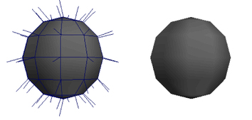

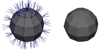

Vertex normals determine the visual smoothing between polygon faces. Unlike face normals, they are not intrinsic to the polygon, but rather reflect how Maya renders the polygons in smooth shaded mode.

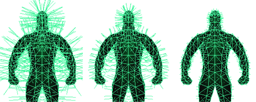

Vertex normals appear as lines projecting from the vertex, one for each face that shares the vertex.
Advanced users may want to manually manipulate vertex normals to create the appearance of hard edges (creases) and shadows without using additional geometry. You can manually manipulate the vertex normals using the Vertex Normal Edit Tool (Mesh Display > Vertex Normal Edit Tool). When the vertex normals for a polygon mesh are manually edited they become locked or frozen. When you unlock a previously locked vertex normal, Maya automatically recalculates the vertex normal for the face based on its default normal calculations.
