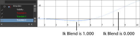

When you use Set IK/FK Key to animate between IK and FK (and vice versa), the Graph Editor displays the animation curves of the IK handle and its joints partly as solid lines and partly as dotted lines.
For example, when you display an animation curve for the IK handle’s Translate X, Y, or Z channels, the curve is displayed as a solid line when Ik Blend is 1.000 and as a dotted line when Ik Blend is 0.000. In other words, the solid line shows where the IK handle controls the joint chain’s animation and the dotted line shows where FK (keyed joint rotations) controls the animation.
