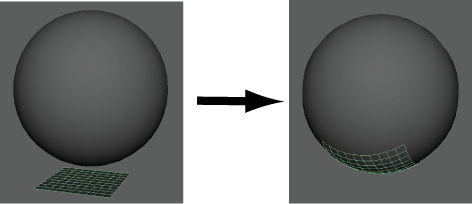

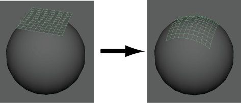

By default, each vertex of the wrapper mesh snaps to the closest point on the target mesh along its normal. You can change this behavior by adjusting the
Conform Options (
Mesh > Conform >
The placement of the wrapper mesh determines the section of the target mesh that is wrapped. In the following example, the sphere is placed at world origin. The plane wraps to different parts of the sphere depending upon its original location:
