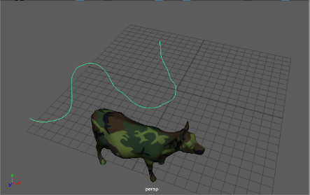

Before starting this procedure, identify a curve to use for the path. It can be one that you import or create with one of the curve tools. See
Draw NURBS curves. You can select a curve tool to create a smooth or jagged curve, depending on the type of animated movement required.

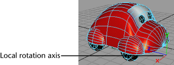

Before attaching the object to the path, it is recommended that you ensure correct orientation of the when it travels down the motion path. You should be able to identify one of the X, Y, or Z axes on the object as the forward direction, and another as the upward direction. If this is not the case, or if you want to verify the object orientation, use the following procedure:
To adjust object axis orientation
- Select the object you want to move along the path curve.
- Click the
Select by component type button in the Maya status line (toolbar) to switch to component selection mode.
- Right-click the
Select miscellaneous components option and turn on the
Local Rotation Axes option in the menu that appears.
This lets you select the Local rotation axes for the object.
- Select the
Rotate Tool, and select the local rotation axis of the object.
- Rotate the axes so that one axis points in the direction of the front of your object, and another axis points in the up direction of the object.

To create a motion path by attaching an object to a curve
- Select the object you want to animate on the path, and then Shift-select the curve.
Note: You can Shift-select multiple objects and attach them to the same path curve. Remember to select the path curve last.

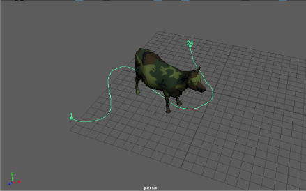

The object moves to a point on the curve as specified in the
Time range setting.
Two motion path position markers with numbers appear at each end of the curve. These markers indicate the start and end frames of the animation path.
- To view the animation of the object, click the Play button in the Playback controls.
