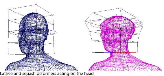

You can add deformation effects to your characters and objects to enhance their animations. Deformers are tools that let you transform or animate objects in ways that simple manipulation and keyframes cannot. In other software packages, the terms modifiers and space warps are used to refer to what Maya calls deformers.
Deformers have two main applications: to model surfaces or to add extra shape animations to an object.
You can use deformers as modeling tools for shaping NURBS or polygonal objects. You can create a deformer, and tweak the model’s shape with it. When you are finished modeling with the deformer, delete it along with the rest of the object’s history (choose ). When you delete the object’s history, the deformer is deleted, but all the deform operations are baked into the object’s shape so that it retains its final deformed state.
Note that in the context of modeling, an object’s history can be called its construction history.
You can use deformers as animation tools. You can create a deformer, tweak the target object with the deformer, and then key the deformer’s attributes over time to produce an animation.
