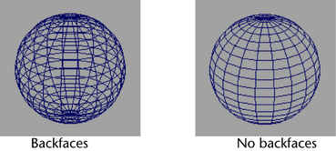

Backface Culling
Draw only what is facing the camera in the 3D view in the wireframe mode. You can improve performance on some systems by turning on Backface Culling.
Off
By default, Maya turns backface culling off. All wireframes are shown.
On
Surfaces appear invisible in areas where the normal points away from the camera.

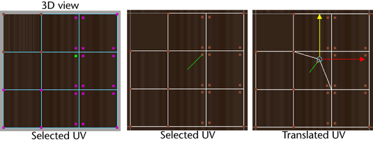

Unshared UVs
Show the UV texture coordinates (UVs) on your object.
If UVs are shared, they display as single purple dots.
If the UVs are not shared, multiple purple dots display close to the vertex to which a given UV belongs. When you select the UV in the UV Texture Editor, a line displays pointing to the face it belongs to.
Turn on the Unshared UVs option to display and be able to select unshared UVs.
