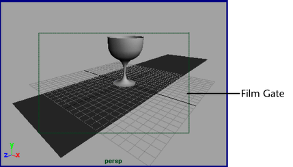

Displays a border indicating the area of the camera’s view a real-world camera records on film. The dimensions of the film gate represent the dimensions of the camera aperture.
The film gate does not represent a bake region. You can customize the region using the Camera Aperture and Film Fit attributes in the camera Attribute Editor.
Displays the viewable frustum according to the film back size. The aspect ratio of the window determines what you actually see. Also sets the camera Overscan attribute to 1.5. The following illustration shows the film gate representing the maximum viewable area.
