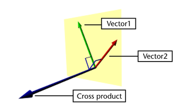

Returns the cross product of two vectors.
For two vectors, the cross product returns the vector that’s normal to the plane defined by the two vectors.
