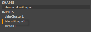

The Shape Inverter essentially allows blend shapes to be added before skinning by inverting the shapes so that they produce the proper results after the skinning deforms the mesh.
Blend shape deformers are often used to create deformation effects on a skinned character, so Pre-deformation assures that the effects from blend shape deformation occur before those caused by the skin. For more information on doing this, see Create pre-skinning corrective shapes.
You shouldn't use the Pre-deformation option if there are nonlinear deformers (Bend, Flare, Sine, Squash, Twist, Wave) or any of the following deformers in the object's history: Lattice, Wrap, ShrinkWrap, Wire, Wrinkle, Muscle, Soft Modification, Sculpt, Texture, Jiggle, and Point on Curve. This is because the effects of these deformers are not supported by the Shape Inverter, so the results from the Blend Shape deformer won't be correct when they're evaluated after Blend Shape.
However, if you need to use the Pre-deformation option in this case, the best solution is to turn off all unsupported deformers, either by selecting the Has No Effect option for the deformer node's attribute, or by setting the deformer's Envelope attribute value to 0 (no influence).

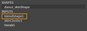

Maya positions the blendShape node so that it's evaluated after all the other deformers on the selected object. In the object’s history, the BlendShape node will be placed above all other deformers, directly below the object's Shape node.
Post-deformation shapes are mainly used for sculpting corrective shapes on skinned characters - see Create post-skinning corrective shapes for information. These target shapes must be either Tangent Space or Transform Space type (see Add Blend Shape Target Options).
The Post-deformation order ensures that the corrective shape is evaluated after the effect of the skin deformation has been calculated, so the deltas are smaller and the deformation is generally smoother than with Pre-deformation shapes.
