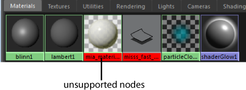

The Hypershade indicates when a node is unsupported by the currently specified renderer in the Texture Baking Settings window. Unsupported nodes appear with a red swatch label.
